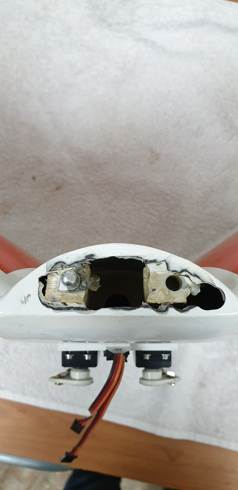

The 2 aluminum duels are placed in 2 hard wood blocks glued to the inner structure. One of the hard wood blocks was not 100% glued to its location. Good thing it happened before flight and it was easy fixed. It also reveled the quality of the internal structure.
