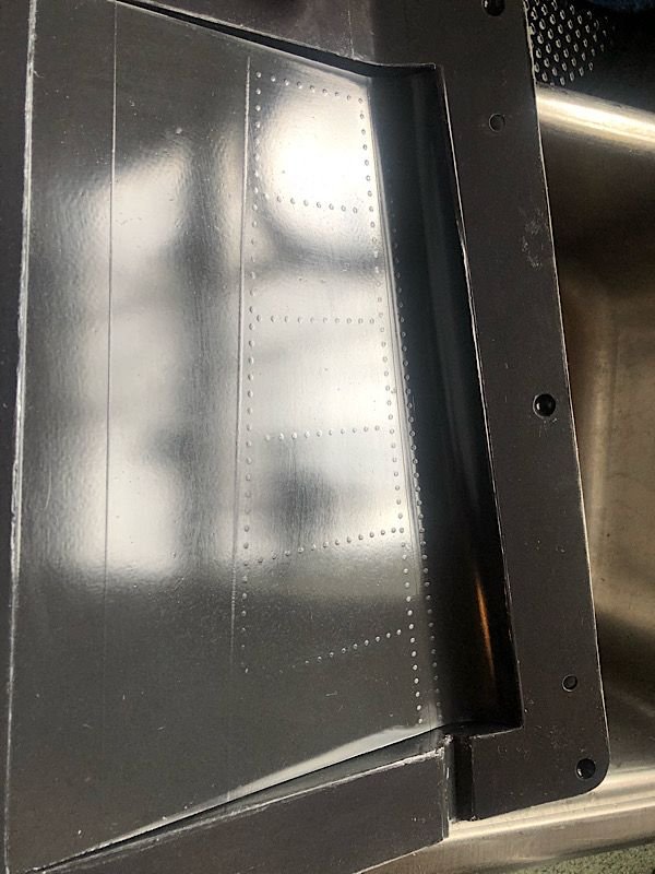

First up, i opened up and washed the rudder mold, it turned out Awesome.. so now i need to do the same to the Horizontal stabs so i can get these molds cleaned and Frekote’d:

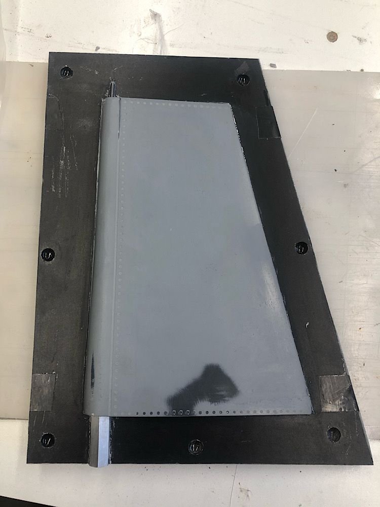

Flap molds are now done!
I then laser cut the vertical stab parting planes, put the V. Stab in place, filled the gaps and sprayed the PVA. Im hoping to have this half of the V. Stab mold done today.

last night i got the first side of the vertical stab molded and trimmed.
here it is with the surface resin in place.
then after about 45 minutes when the resin has cured a bit to where it becomes “stringy” when you touch your finger to it and pull away, i applied some 1.4oz glass strips so the edge of the strip was butted up against the edge or corner of the part/parting plane. This allows the glass to “sink” into the surface resin slightly in an effort to help avoid chipping of the corners.
first side is now all done and curing until its time to trim it once the layup has gone “green”... IE its not completely cured, the laminate can still be flexed with pressure, but isnt wet and sticky to the touch.
the next morning, the first side is sanded flush with the edges of the parting planes, the parting planes removed, the opposite side waxed and then PVA was sprayed.
6 hours later the second side of the mold was done.

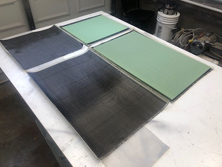

Today’s task was to make up some carbon and airex panels in 3mm and 8mm thickness. These will be used for the internal structures of the vertical stabilizer and wing panels

The Carbon/ Airex panels are done.
I also opened up all the molds, drilled the clamping bolt holes and washed the wax/pva off of them. Once they dry, i will clean them with frekote mold cleaner and then start applying the frekote mold release.

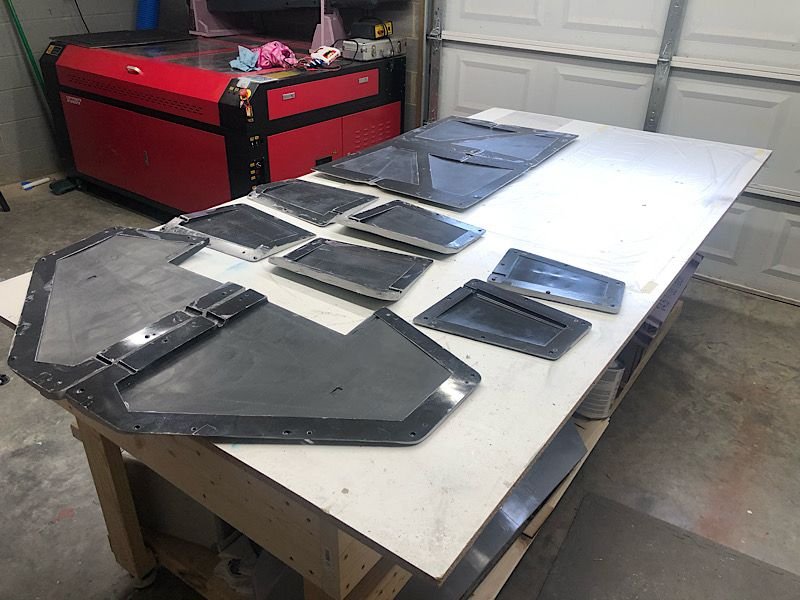

The molds that are done have been cleaned and treated with Frekote mold cleaner, Frekote mold sealer (FMS) and Frekote 770NC. They were then sprayed with primer:
I then printed off some paper test templates for the Airex core material that i drew up in CAD and plan to laser cut:
With the paper test templates fitting perfectly, i went ahead and laser cut all of the airex cores for the vertical stabilizer, both flaps, horizontal stabs and 6 rudders:
I then decided to push the envelope to see how lazy I could be and decided to laser cut the fiberglass fabric layers for the rudder. And for those now wondering, No, the laser wouldnt cut carbon.
your also probably wondering why i have 12 pieces of fabric for a rudder.. well. I cut out enough for 2 rudders to make the most out of the fabric.
the nicest thing about these being laser cut, the fabric doesnt fray which means i can cut out all the glass layers smaller than what would be needed if cut conventionally.

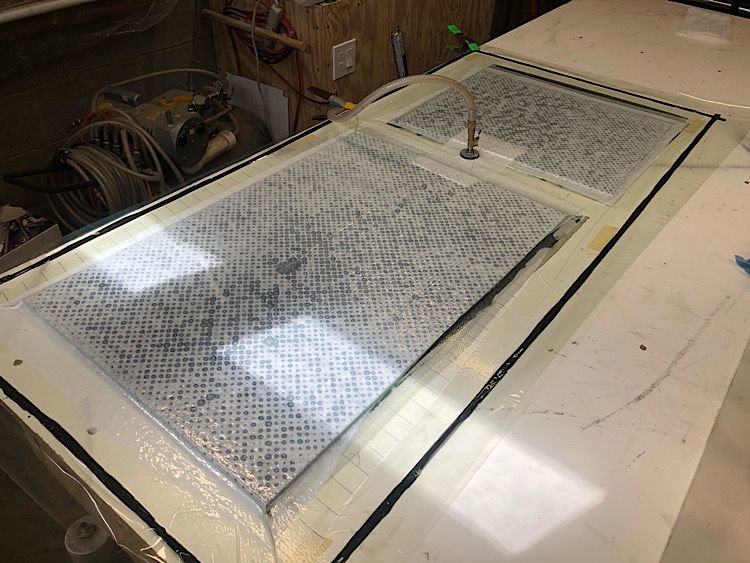

I spent a few hours this morning getting fabric layers cut out in the laser for a few airframes worth of flaps, rudders, vertical and horizontal stabs.
I then laser cut the vertical stab and rudder test internals. These are all cut from 1/8” lite ply before getting cut from the carbon/airex material or aircraft ply.
i then mixed up some thickened epoxy, put a small bead into the corners of the parts and put a light layer of 3/4oz glass in the flaps and a layer of 1.4oz glass in the rudder and left this to “go green”. This first layer isnt vacuum bagged so that the details stay crisp on the part.
After about an hour i started stacking the glass fabric, airex, peel ply, Perforated release film and bleeder fabrics. I was then stuffed in a vacuum bag and will be left to cure overnight.
